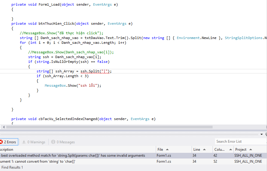

Mình làm y hệt video mà sao lại bị lỗi này nhỉ? @tunvit

Mọi người cho mình hỏi là mình làm sai chỗ nào mà nó không lọc được SSH hư vậy ?
Code:
using System;
using System.Collections.Generic;
using System.ComponentModel;
using System.Data;
using System.Drawing;
using System.Linq;
using System.Text;
using System.Threading.Tasks;
using System.Windows.Forms;
namespace SSH_All_In_One
  public partial class Form1 : Form
  public Form1()
  InitializeComponent();
  private void Form1_Load(object sender, EventArgs e)
  private void richTextBox1_TextChanged(object sender, EventArgs e)
  private void richTextBox2_TextChanged(object sender, EventArgs e)
  private void label1_Click(object sender, EventArgs e)
  private void label2_Click(object sender, EventArgs e)
  private void label3_Click(object sender, EventArgs e)
  private void comboBox1_SelectedIndexChanged(object sender, EventArgs e)
  //if (comboBox1.SelectedIndex == 0)
  //  MessageBox.Show("Loc SSH hu !");
  //else if (comboBox1.SelectedIndex == 1)
  //  MessageBox.Show("Loc SSH trung ca user va password");
  private void button1_Click(object sender, EventArgs e)
  if(cbTacVu.SelectedIndex == 0)
  Loc_SSH_Hu();
  else
  MessageBox.Show("Cac chuc nang khac se som co :)");
  //MessageBox.Show("Thuc hien tac vu");
  public void Loc_SSH_Hu()
  string[] danh_sach_Nhap_Vap = txtDauVao.Text.Trim().Split(new string[] { Environment.NewLine }, StringSplitOptions.None);
  for (int i = 0; i < danh_sach_Nhap_Vap.Length; i++)
  string ssh = danh_sach_Nhap_Vap[i];
  if (string.IsNullOrEmpty(ssh) == false)
  string[] ssh_Array = ssh.Split('|');
  if (ssh_Array.Length >= 3)
  txtDauRa.Text += ssh + Environment.NewLine;
  //MessageBox.Show("SSH" + ssh + "la SSH loi");
Code:
using System;
using System.Data;
using System.Linq;
using System.Text;
  public Form1()
  Loc_SSH_Hu();
  else
dòng này
Code:
nên thay bằng dòng này dễ hiểu hơn
Code:
string[] danh_sach_Nhap_Vap = richTextBox1.Text.Trim().Split(Environment.NewLine.ToCharArray());

dòng này
Code:
Code:
String[] danh_sach_Nhap_Vap = richTextBox1.Lines();
ngắn gọn xúc tích :D
